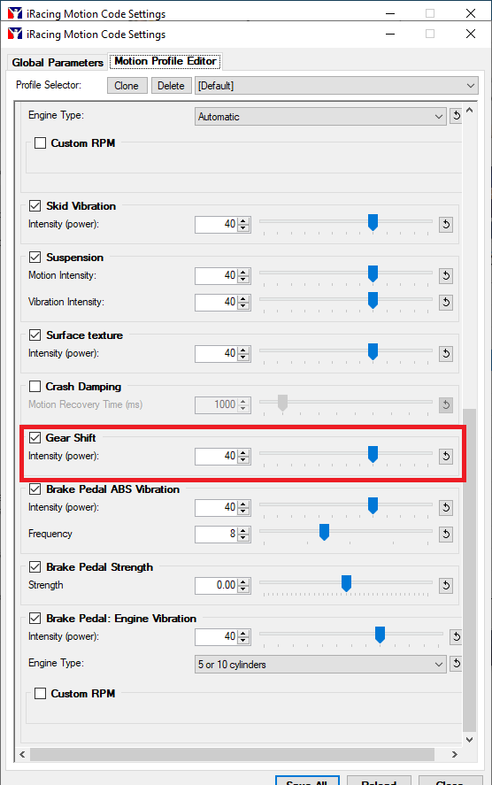

I’d say D-BOX motion code settings for iRacing is kind of broken – the Gear Shift slider has no effect. Whenever you increase Front-Rear Acceleration gear shifting nearly shakes my brains out and you cannot make it less intense. If decrease the reactivity to compensate for gear shifting the front-rear acceleration also decreases.
Has anyone solved this?

Hi Marc, I have the same issue. Shifting at low speeds is very unrealistic. For example coming out of the pits the upshifts are unrealistically intense. How can this be changed in settings?

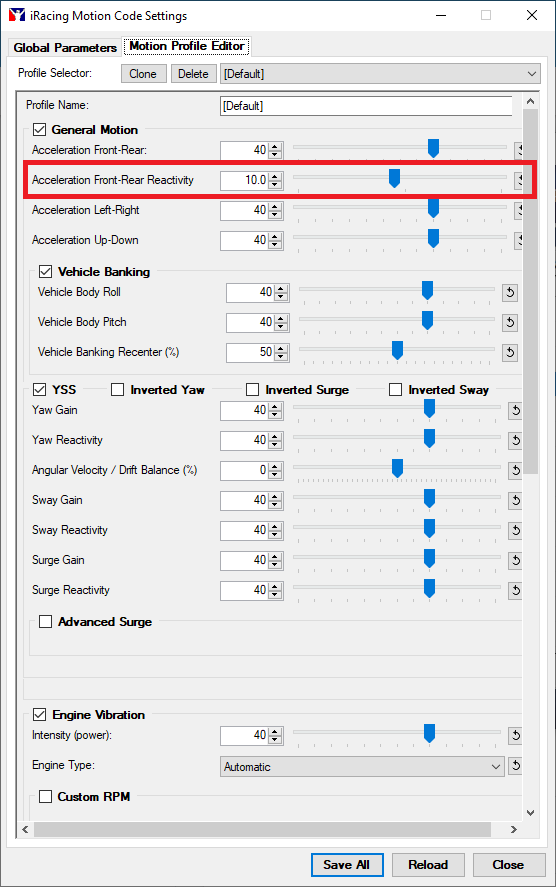

Hi Henry! You could adjust “Acceleration Front-Rear Reactivity” and “Gear Shift” intensity. If reactivity is too intense, this could get the movements to be softer, but you’ll loose more drastic effects like gear shift.

I am of the same opinion, the gear change shakes my head and it is very unpleasant.
If we reduce the Front-Rear Reactivity acceleration, then we no longer have any feeling when braking.
Isn’t it better to separate shifting from acceleration Front-Rear?
This problem is very marked with the Porsche 911 GT3 R !

I hope you will find a solution that works and quickly because currently I am in my “Acceleration Front-Rear” setting at the minimum and I do not feel the braking at all. What I dislike because it is the basis of a simulation the feeling of braking.
